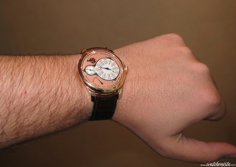

On the one hand, the dial was designed with a wide aperture to showcase the path of the Remontoir d'egalite. I personally like this feature; it reminds me of the first Journe from the beginning of the 90's; but certain purists of "small dial apertures" won't appreciate.
On the other hand, another characteristic will trigger contrasted reactions: A Dead-beat second wheel is attached to the Remontoir d'egalite, on the movement side. Again, to me this choice is relevant, because the spasmodic movement of a dead-beat seconds hand makes me hysterical. Furthermore, it rotates opposite to the main hands, which could be a visual disturbance if you wear the watch every day.
However, some people could appreciate a certain form of dandyism conveyed by this dead-beat second hand.
A brilliant technical feat means nothing without the appropriate look and the main interest of this piece is its very fine design. I undoubtedly tried on the most beautiful and the most "Journe among the Journe" presented in recent years.
The watch is impressive because of its perfect proportions (40 or 42mm depending on the model, for 10 millimeters in thickness). The model displayed on the wristshots is a 42mm. It will be a bit too large for the smallest wrists, but on mine it looks even thinner because of its width. Here I have to make a point: it is imperative to try on a FP Journe, as it is so difficult to capture all its aesthetic subtleties with a camera.
The large dial is a relevant choice, as it makes room for large sub-dials and thus preserves the legibility. It also emphasizes the diverse finishes, notably the relief painted numerals or the magnificent powdery dial.
The watch is available in platinum or in red gold. I prefer the latter as it features a magnificent rose gold dial, which creates a very consistent look with the movement made of the same metal.
As you will probably have guessed, this piece is really appealing and I had trouble giving it back.
The price, 85k CHF, prevented me from leaving with it... At least for the moment.
Indeed, this "Chronometre Optimum" is a great work from Journe. In my opinion, it summarizes these basics: a chronometric watch, therefore a regressive work of absolute optimization of an outdated technology.
