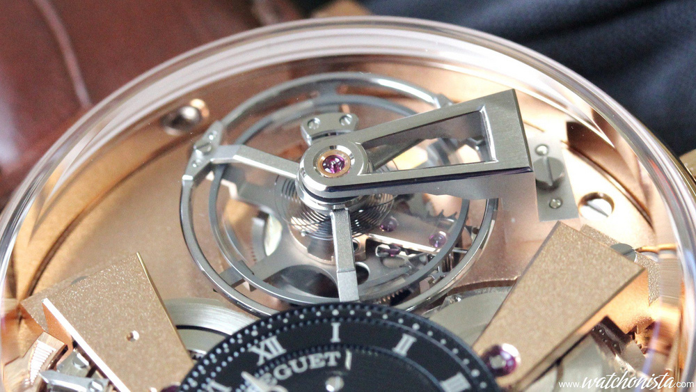

The 7047 is super-demonstrative, the path of the chain is fascinating and the rotation of its One-minute tourbillon is mesmerizing. For that matter, the chain is far bigger than the competitors' and perfectly resonates with the large silicon balance (13mm) and the very large (17mm) titanium tourbillon carriage. The overall color in gray tones is in good taste, and perfectly matches the very clean and very rough sand-blasted finish. It is the opposite of a first communion watch. One can even go further by saying that it is different from the dominant style in the high-end market. When it takes a magnifier to appreciate the bevelings of a Dufour, here, one has to look at the watch from a distance, as the design is so brutal. While it is not "showy", it nonetheless impresses at first sight, it is impossible not to notice it.
The specificity of this version is that, akin to the Breguet Tradition 7057 without tourbillon, its bridges are red gold coated. In my opinion, it is the most suitable for this model, because the white gold version is too cold, the ruthenium version is too modern and the yellow gold version is too vintage. The red gold finish combines the vintage look of yellow gold and the dynamism of ruthenium. The warmth of red gold creates a contrast with the sharp bridges. The caseback is the most beautiful of the "Tradition" collection. And it is probably the most successful watch of the series: the 7027 was very nice, but a little too sober; the 7057 was funkier, but this 7047 is totally a beast! Here, Breguet did not try to do something cute. They tried to do something in the style of Abraham-Louis Breguet: everything is off centered, asymmetrical, the tourbillon uses as much room as the hour-dial, it is functionality before its time.

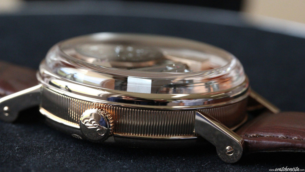

The watch is of course thicker. But the brand utilized quite a legitimate trick: the domed sapphire crystal allows for a moderate thickness as compared to the diameter.
Moreover, it allows us to admire the One-minute tourbillon from a lateral axis, which is difficult with a flat crystal. This configuration, which combines fine build, curved glass and thin bezel (like the pocket watches of XVIII) has another advantage by allowing more light into the movement. The domed glass makes the thickness of the mechanism acceptable, without having to rely on a XXL watchcase...
In fact, one should not mix the real thickness with the crystal, 16.6mm, and how it looks when worn on the wrist, about 13mm.

The most surprising parts are the tourbillon screws. Indeed, the components are so fundamentally optimized, between the constant torque and the theoretically perfect silicon assembly balance/hairspring, that the gold fine-tuning screws of the titanium tourbillon look a bit superfluous... Maybe it is not possible to get same level of precision in machining with titanium... The last question aroused by such a particular escapement device, is that of legitimacy: what would have been the comments if there was no Breguet curve. Let's go even further: wouldn't it have been heresy not to put a Breguet curve on the hairspring, even if made of silicon, on a watch from the firm created by the inventor of the Breguet hairspring and of the tourbillon?
